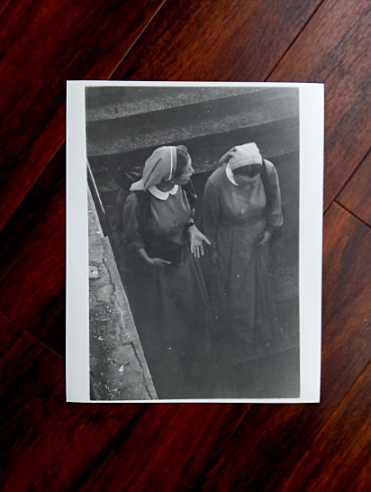

Split grade print, just made.

And Erik's prints look great, I just don't see anything in them that comes from split grade printing.
I take that as a compliment. For years I did not know how Cartier-Bresson's pictures were printed. I did not even know that something like split printing existed. But I wondered how HCB's prints where made. They have at the same time A. beautifully light gray highlights (solid tonal highlights) and B. deep velvetly black tones (for example in bowler hats or in shiny leather). I could not achieve that on single grade paper. Finally I found out that the prints of Cartier-Bresson were achieved by split grade printing (was told me by a printer who worked for many years in professional darkrooms in Paris). I tried do do it myself and hopla, I got it, pretty easy in fact.
Erik.

I have the opinion that printing a negative is not making a painting. You only have to print the negative as perfect as possible.
If you feel the need for burning and dodging in split grade printing, do it only during the exposure with the 00-filter. The exposure with the 5-filter is much to short for that. The exposure with the 5-filter is only a flash afterwards that takes care of the darkest parts of the picture.
I almost never use burning and dodging.
Erik.

Old 3 Days Ago   #60
LeicaFoReVer
Addicted to Rangefinders
LeicaFoReVer's Avatar
LeicaFoReVer is offline
Join Date: Jul 2008
Location: Turkey
Posts: 1,367
https://drive.google.com/file/d/1Sh2...w?usp=drivesdk
That is my print with split filter method. I am a beginner and this is my first print of this shot and 6th split filtering experience or so. Yellow cast is due to mobile phone camera.

Old 3 Days Ago   #61
Erik van Straten
Erik van Straten's Avatar
Erik van Straten is offline
Posts: 8,675
Originally Posted by LeicaFoReVer View Post
Hi Erik,
I really want to hear your opinions on how to choose the right exposure for each filter like Mike mentioned above. Do you agree on what he said?
Very easy: first I determine the lightest spot on the photograph = the darkest spot on the negative. I decide if I want this spot to be white or slightly toned. Then I make a test on a small piece of paper to find out the shortest possible exposure time. I make a complete test with both exposures, with both filters, 00 and 5. I make also a test for the darkest part of the picture.
For variations of the light tones the exposure with filter 00 is relevant and for variations of the darkest tones the exposure with filter 5 is relevant, but tests must be done with both exposures. One exposure only is not of any help.
I do not understand the writings of Mike. It is difficult to write about visual experiences. Maybe it helps me to write about split grade printing that I am a professional writer (in Dutch).
Erik.
