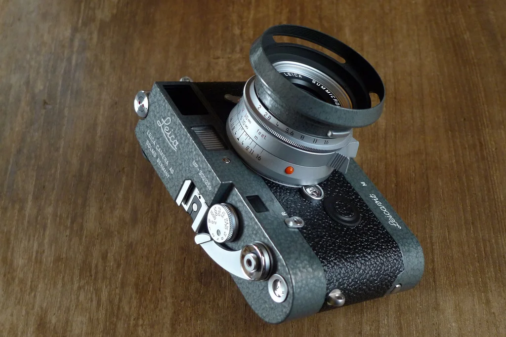

I wish someone would repaint in Hammertone. So pretty with the silver dials!

Posts: 7,505
Hammertone is my favourite finish. Just looks fantastic.
The same guy as above also does hammertone, different kinds:
