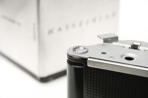

Hi folks!
Many thanks to all of you for this inspiring thread, which helped me to try 70mm in 2022.
Since I came too late for the new perforated Rollei from macodirect (they answered me a few months ago that it is no longer produced), the only (cheap) option was Agfa Aviphot from an Indian seller on eBay.
Since I accidentally bought the unperforated film, I decided to make my own rubber wheel for Hasselblad A70 film magazine:
If you need one (or a few), I listed them on eBay, just tap "70mm Unperforated A70" and you will find them, or dm me here.
I produce and ship them from Ukraine. Our post service is doing impossible job by delivering parcels from and to abroad like nothing is happening.
The rubber wheel works just as the original one, keeping the frame spacing the same. Installation is easy and reversible.

Hi Igor_i,
THANK YOU for making these available.
"If somebody here wants to pursue it, Hasselblad A70 Mags can be adapted to run unperforated 70mm film. A cog of the proper specs would need to be manufactured and tested. I have ONE left and it's worked for me, actually I had a Kiev88 that took Blad backs, and I used that to shoot unperforated 70mm. Somebody should take this up and report here. It's quite doable, and it's reversible, too."
I just bought two of these for myself. Using a rubber ring with a "V" imprint is clever; that should double the pulling power of film through the magazine.

Hasselblad A70 70mm Film Back "Rubber Wheels" arrived today from the Ukraine! They look good and I'll test them as I have time. Replacing these cogs with the "sprocket wheel" in the A70, allows you to run unperforated film in the Hasselblad 70mm Film Magazine. Which really opens up a lot of 70mm film options, there is a lot of unperforated out there. Top sides and bottom sides shown here.
